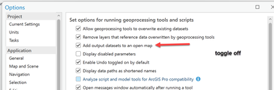

on a general basis
If running from notebooks or the python window, you can control it from environment settings see
env—ArcGIS Pro | Documentation
EnvManager—ArcGIS Pro | Documentation
... sort of retired...
JohannesLindner
MVP Alum
current_setting = arcpy.env.addOutputsToMap
arcpy.env.addOutputsToMap = False
# your code
arcpy.env.addOutputsToMap = current_setting
Have a great day!
Johannes
