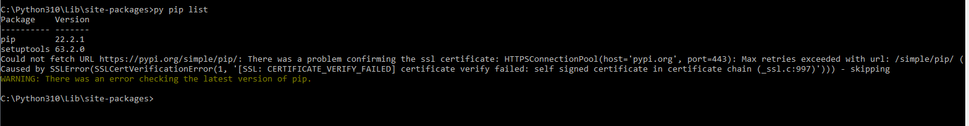

Maybe a firewall issue on my side?  Can I download it and install locally?
I try at this location
Tryin to install urllib3
I can get their via web browser

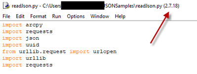

As for setting the interpreter/ env in IDLE, when you open it, it should list the env/ interpreter at the top:
Python 2.7.18 (v2.7.18:8d21aa21f2, Apr 20 2020, 13:19:08) [MSC v.1500 32 bit (Intel)] on win32
Type "help", "copyright", "credits" or "license()" for more information.
You can also use: python at a normal cmd prompt and it should list what python interpreter the system (and most likely the python that is being used to execute in bat file) is using.

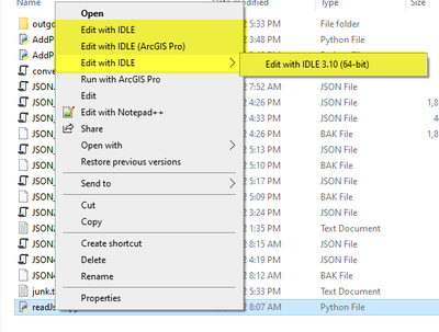

OK so here is where I am currently at.  I am pretty confused why this is not working....
Below are my 4 options when I go to run the .py file

1st Option - Edit with IDLE
This open it in IDLE 2.7 which was a prior install of python that is on this computer
Error -
File "C:\Users\tjv36463\Desktop\JSONSamples\readJson.py", line 5, in <module>
from urllib.request import urlopen
ImportError: No module named request
2nd Option - Edit with IDLE (ArcGIS Pro)
If I choose this option
Error -
File "C:\Users\tjv36463\Desktop\JSONSamples\readJson.py", line 13, in <module>
response = urlopen(url)
File "C:\Program Files\ArcGIS\Pro\bin\Python\envs\arcgispro-py3\lib\urllib\request.py", line 222, in urlopen
return opener.open(url, data, timeout)
File "C:\Program Files\ArcGIS\Pro\bin\Python\envs\arcgispro-py3\lib\urllib\request.py", line 531, in open
response = meth(req, response)
File "C:\Program Files\ArcGIS\Pro\bin\Python\envs\arcgispro-py3\lib\urllib\request.py", line 641, in http_response
'http', request, response, code, msg, hdrs)
File "C:\Program Files\ArcGIS\Pro\bin\Python\envs\arcgispro-py3\lib\urllib\request.py", line 569, in error
return self._call_chain(*args)
File "C:\Program Files\ArcGIS\Pro\bin\Python\envs\arcgispro-py3\lib\urllib\request.py", line 503, in _call_chain
result = func(*args)
File "C:\Program Files\ArcGIS\Pro\bin\Python\envs\arcgispro-py3\lib\urllib\request.py", line 649, in http_error_default
raise HTTPError(req.full_url, code, msg, hdrs, fp)
urllib.error.HTTPError: HTTP Error 403: Forbidden
3rd Option - Edit with IDLE (Edit with IDLE 3.10 (64-bit))
The 3rd options opens in this
Error -
File "C:\Users\tjv36463\Desktop\JSONSamples\readJson.py", line 1, in <module>
import arcpy
ModuleNotFoundError: No module named 'arcpy'

Just for FYI, option one (2.7) IDLE is using the Python 2.7 environment, which you noted is from an old install, (but may still be used for other programs) and since you have been working in 3.10, this 2.7 will not have any of the packages that you installed. And its syntax is different so it would most likely fail trying to interpret the 3.x syntax.
Option 2 is pointing to the IDLE packaged with Pro, so good there.
Option 3 is pointing to the base Python3.10 install for your system and since Pro has it's own, arcpy is not installed into the system environment.
Option 4 is good, but it was getting tripped up trying to decode the page.
