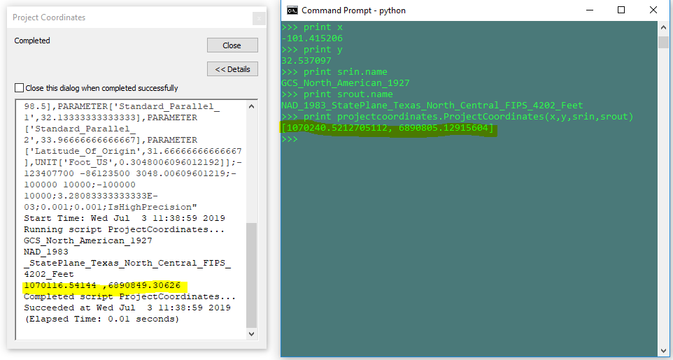

So, i have a python function defined that projects coordinates using the 'projectAs()' point geometry function. When i call this function in a script from a toolbox it gives different results vs calling it in a python command prompt window. See below python function below:

Results of Each:
Can anyone replicate this? Does anyone have any ideas why this is happening?
Also, if it helps, I know from surveyed data that the toolbox script output is correct and the command prompt output is incorrect.

I did some testing and can confirm that the tool script and code run in the Python window produce different results.  I believe this is due to an automatic transformation that is occurring when the tool is being run.  The GCS NA 1927 coordinates appear to be transformed into GCS NA 1983 using NAD 1927 To NAD 1983 NADCON.
As an experiment I created two layers: the Texas State Plane that you are working with, and a GCS NA 1927.  The state plane was populated with two points located at the positions you highlighted in your results.  The GCS 1927 was populated with one point using the lon/lat in your script.  The state plane was placed in a new map.  When adding the GCS 1927 layer a transformation dialog was presented.  If no transformation was selected, the GCS 1927 point was placed over the state plane point located at 1070240.5212705112, 6890805.12915604.  If the NAD 1297 To NAD 1983 NADCON transformation was used, the GCS 1927 point was located over the state plane point located at 1070116.54144, 6890849.30626.
While experimenting, I noticed that the Add Geometry Attributes tool also automatically included the transformation.

ptGeometry = arcpy.PointGeometry(arcpy.Point(x,y),arcpy.SpatialReference('NAD 1927')).projectAs("NAD 1983 StatePlane Texas N Central FIPS 4202 (US Feet)","NAD_1927_To_NAD_1983_NADCON")
print ptGeometry.firstPoint.X, ptGeometry.firstPoint.Y
# result: 1070116.54144 6890849.30626
It seems that when you use a "transformation_name", the associated "spatial_reference" must be a name (not a factory code).  This document ArcGIS 10.7.1 and ArcGIS Pro 2.4 Geographic and Vertical Transformation Tables was helpful.
