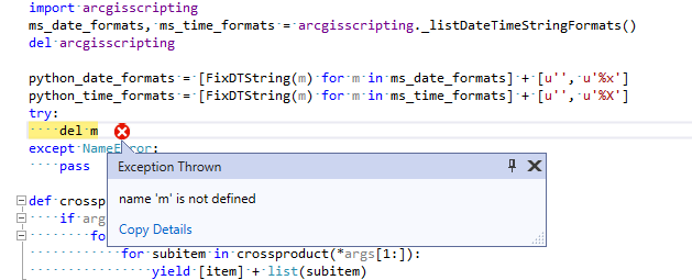

I have created a python script file that I am debugging it using visual studio 2019, But as soon as I try to debug, it gives me and Exception on another file (time.py - not sure where it came from as this time.py is not in my project or folder) stating "name 'm' is not defined" (I am attaching a video of the exception). Any help is appreciated.

I have the same issue. It looks like when I import arcpy in Visual Studio, it loads 'arcpy.time', and it doesn't matter if I use any datetime functions in my code but the debug detects the name error.
I opened the time.py file and in line 267, there is a variable m
try:
del m
except NameError:
pass
I cannot modify this time.py file since it's part of arcpy package. Don't know how to solve this problem.

I'm running into this same message too when adding "import arcpy"
It's annoying but is this actually a problem? I notice you can just click "Continue" on the visual studio toolbar and the rest of my project runs fine.
Also, if I choose to "Debug"-> "Execute Project in Python Interactive" there's no error at all.
