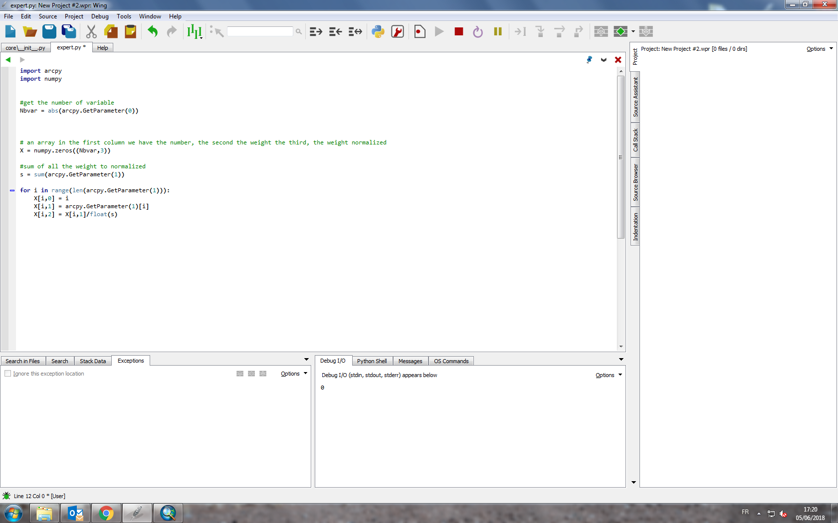

Hi everybody,
I just begin to work with argis and after a long and hard work for loading the arcpy module, i face a new problem.
I'm sure it is pretty simple but i do not have all the habits yet.
I have to make a script in python, in the script the user gives the number of variables and all the weights of these variables and the script return the new weight of these variables normalised.
  • Example, 2 variables that have the weight 2 and 4 and the script return 2/6 and 4/6
The code is easy, i use arcpy.GetParameter to get Var_Number but i dont know how to iterate on it, and how to return the new weight.
Thank you for reading me.
here is my code

Do you just want to see it? or do you intend to use it later on?
arcpy.AddMessage(str(yourarray))
will 'print' it as a result

If you are using numpy, why are you looping?  input your 2nd variable as a list comma-separated string, then parse and convert to either integer or float.  The final array will have to be of float kind unless you want to specify the array dtypes to produce a structured or recarray.
Here is an example removing the looping
