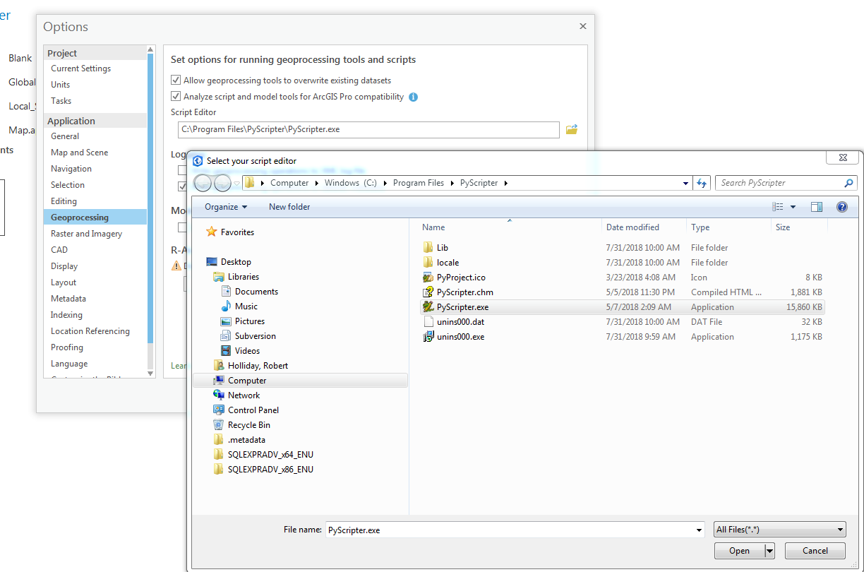

Hi, I'm having difficulty setting the IDE used opened by ArcGIS pro when I right-click a script and select Edit. I have tried to enter the filepath to pyscripter.exe in under geoprocessing options, but even so only the standard text editor opens. Any idea what I'm doing wrong?

Joe, yes, I can now get PyScripter to open when I click Edit script. It may be the recent update for ArcPro, or it may be that a few weeks ago I installed both Pyscripter 2.7 and Pyscripter 3.6 - although I did not touch the pathing since my last attempt, the version of Pyscripter was set to 2.7 when I first opened it through editing an ArcPro script.

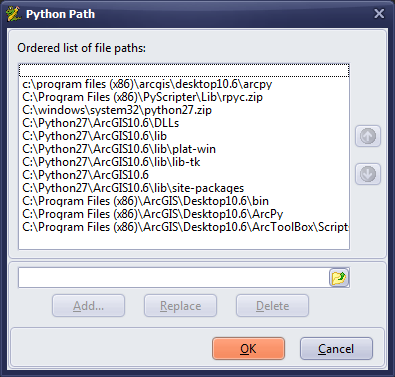

I like PyScripter and I have the need for both x32  and x64 Python. So far this is working.
Starting from a fresh install (I have had bad luck with updates) I solved this problem by first installing and Configuring Arcis Pro 2.2.x.  I then installed and configured PyScripter 3.4.1 x64 to use the Anaconda Virtual environment IE PyScripter x64 launches using the Python Install in C:\Program Files\ArcGIS\Pro\bin\Python\envs\arcgispro-py3.
Then I installed ArcGIS Desktop 10.6.  Finally I installed PyScripter 3.4.1 x32 which detected Python 27 which was installed with ArcGIS Desktop.
