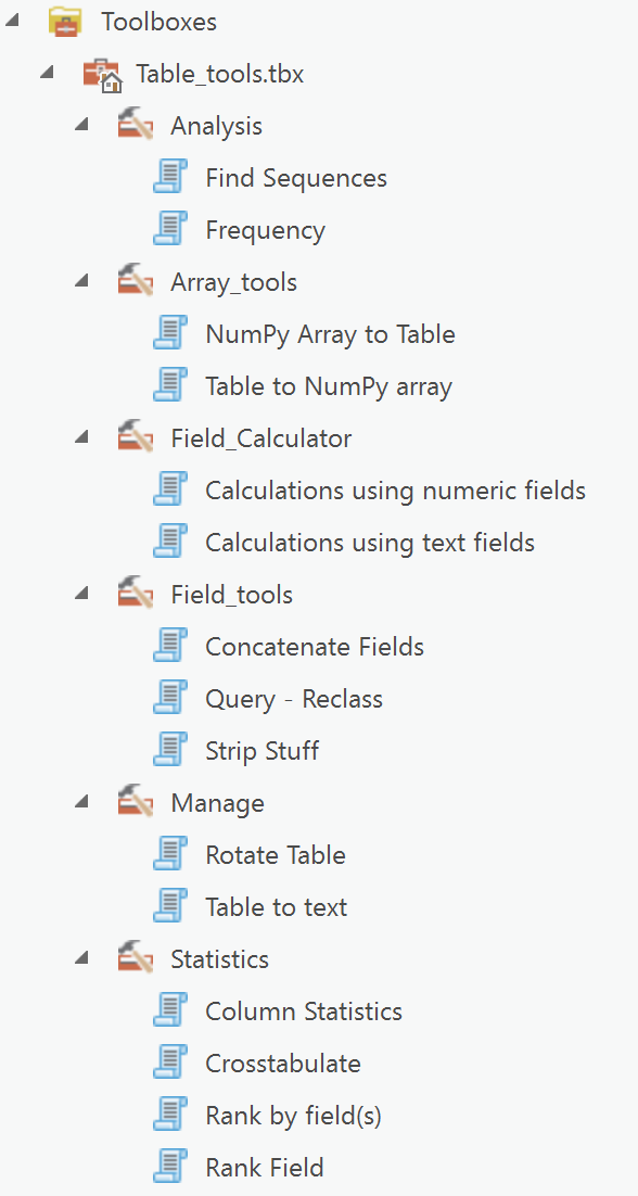

Also... put those scripts in a toolbox, I can't tell from the movie whether you are using catalog view or whatever.
You can even set up a default toolbox if needed, or use the one that is created in your project.   When you right-click on one of those scripts, Spyder does open to edit it.

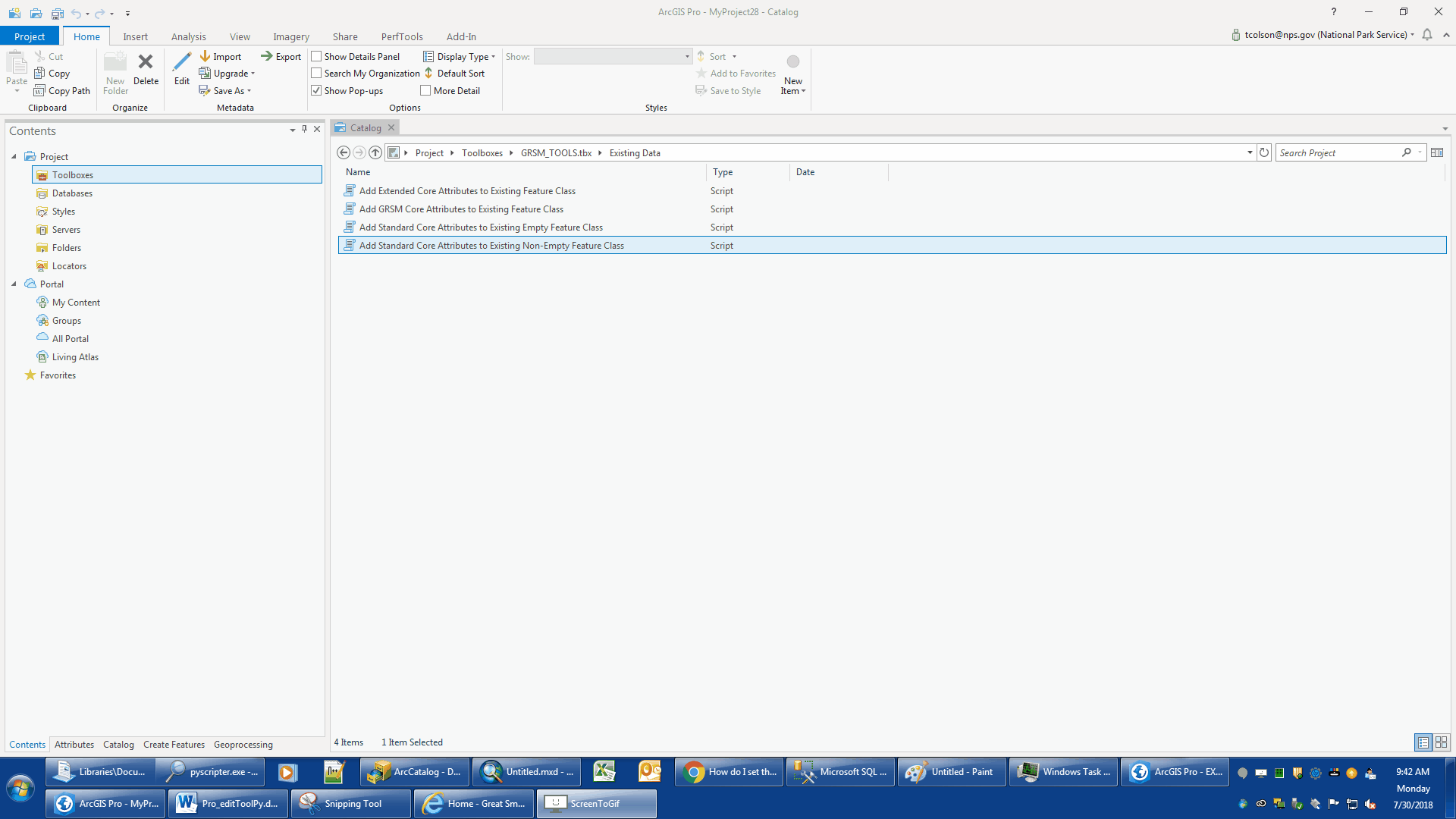

Dan, the problem is, I can't really customize my py or pro environment, we're moving toward centralized installs/images, even on my machine, so Spyder is not in the cards...scripts are in a toolbox....
Michael, not sure what searching is....I have a toolbox embedded in a Pro template with the scripts "Imported". When I open a new project using the template, and attempt to "edit" a script, all I get is notepad (most of the time) regardless of what py editor I list in options.

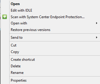

Have you tried going directly to the location of the script on your network in Windows Explorer and right-clicking on the script file?  When I do this on my network I get the following options after a default installation of Pro:
I choose Edit with IDLE and I'm using IDLE to modify and run my script and not NotePad.

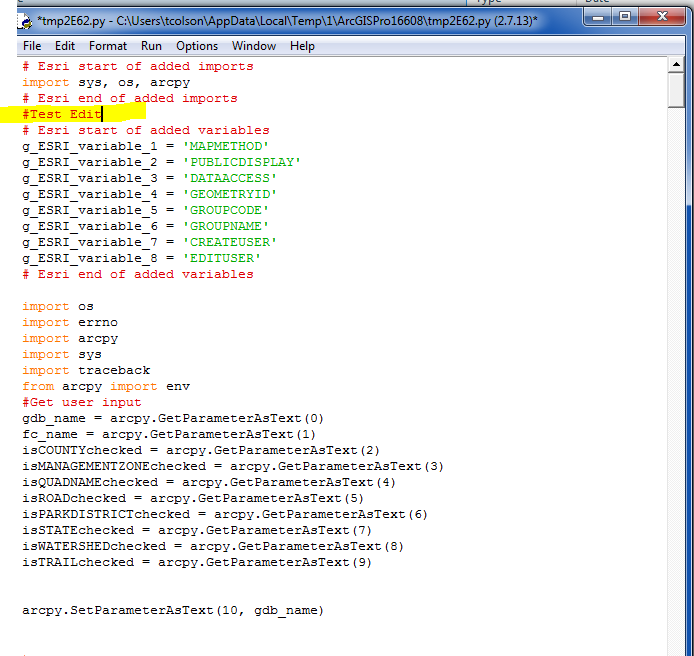

Yeah, that location changes with each new project. Here's an instance of where it opens in Idle:
Make an edit:

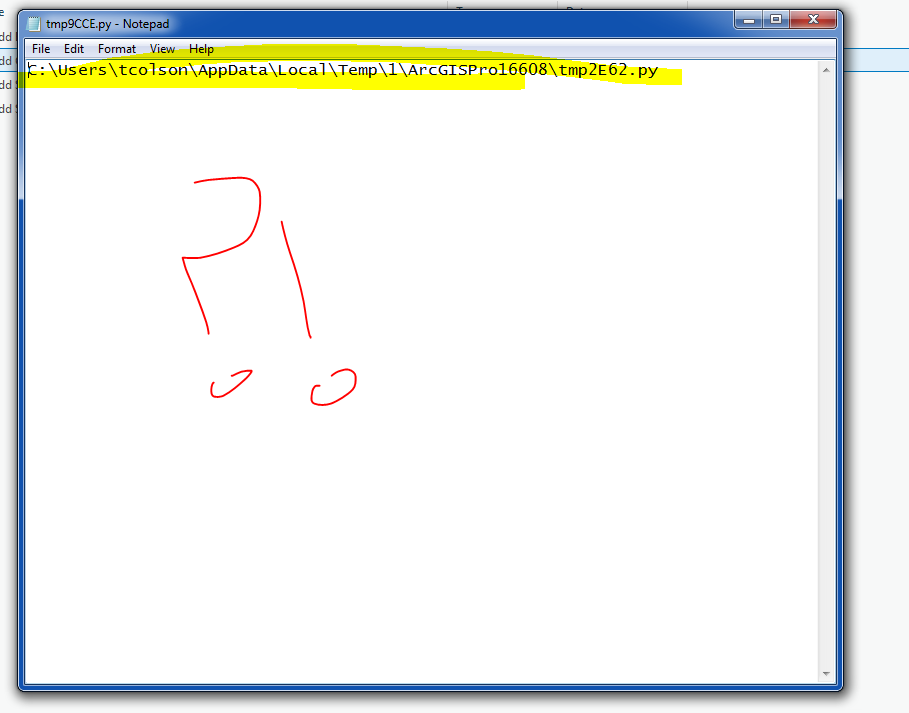

Save, and reopen in editor. Defaults back to notepad, deleted the script:
