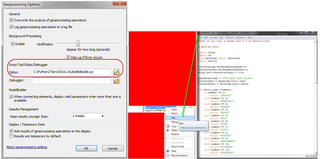

The file you put into the Editor text box should be “C:\Program Files\ArcGIS\Pro\bin\Python\envs\arcgispro-py3\Lib\idlelib\idle.py” like with ArcMap before it (see below).
   But doing something similar and using "C:\Program Files\ArcGIS\Pro\bin\Python\envs\arcgispro-py3\Lib\idlelib\idle.py" should work but it didn't for me.

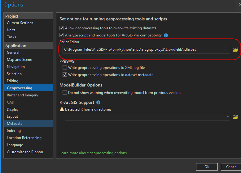

An odd workaround is to use "C:\Program Files\ArcGIS\Pro\bin\Python\envs\arcgispro-py3\Lib\idlelib\idle.bat" like so:
You'll open the script in IDLE... but also in Notepad...
