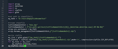

This worked for me using the rename_management function and a shapefile.  It took a shapefile name Kim.shp and renamed it to append todays date... the code to create the zip file works to, but it creates a zip file that starts at the base of the path... if that makes sense.

I don't way but I run your code on jupyter notebook on Arcpro and works fine when I am trying to run on PyScripter I am getting error
#rename shapefile
txtFileNameWithExt = "op.shp"
txtFileNameNoExt = f"{os.path.splitext(txtFileNameWithExt)[0]}_{datetime.datetime.now():%Y_%m_%d}"
arcpy.env.workspace = my_Path
arcpy.Rename_management(txtFileNameWithExt,f"{txtFileNameNoExt}.shp")

seems "f" doesn't work here
SyntaxError: invalid syntax
also here
KimberlyGarbade
"f" substitution only works in Python 3.6 and above.... might have to use an older substitution method.  You could try % formatting... its an older way to do string substitution in Python.
KimberlyGarbade
I wrote mine in Spyder... I don't know much about PyScripter, but maybe it needs a reference to the 'os' or 'datetime' modules
