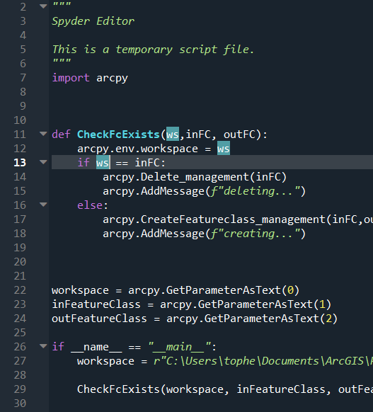

I changed it from inFC==inFC to ws == inFC, but it gives me back an error when I run the tool. i also put the input feature class name without the .shp.
Thank you for your help

Not exactly sure what you are trying to do, but a shapefile normally reside in a folder but you are checking it against a gdb.  Are you trying to see if a featureclass exists with the name of the shapefile (ie minus the .shp extension),

Yeah I'm trying to see if it exists in the gdb, if it does im deleting it, if what I input doesn't exist i'm creating it.

As Dan pointed out, shape files can't exist in geodatabase workspaces, they exist in filesystem folder workspaces.  If you are wanting to see if a certain shape file has a corresponding feature class named after it, strip off the (.shp) on the end of the name:
