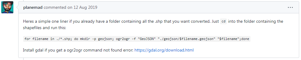

On the GitHub website I found a topic (https://gist.github.com/benbalter/5858851) in which someone may have written what I need:
But I need a script that first runs it, then in the console, the program asks the user for the path to the folder with the .shp files. In addition, if the GeoJSON file with the given name already exists, then before running the ogr2ogr command the program asks the user whether to overwrite it. Can you help me write such a program?
