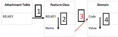

I found this post here but I'm not sure how to put it together; I was able to create the initial dictionary of codes and values, but I'm not sure how to connect that to my fields afterwards.
The code runs as :
  1. Look up the RELKEY from the Attachment Table in the Feature Class
  2. Grab the Name from the Feature Class (End here if no domain or if the domain is a range.)
  3. Use the Name from the Feature Class to Lookup the Coded value in the Domain Table
  4. Grab the Value for the Code from the Domain Table AlfredBaldenweck_0-1644606698839.png
I have steps 1,2, and 4, but I can't figure out how to make step 3 work.
