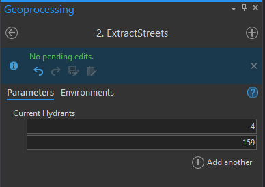

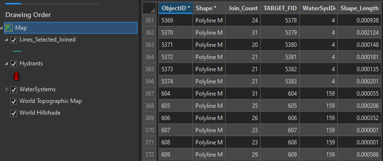

After I perform the spatial join which is line 69 of my code I get an feature class called Lines_Selected_Joined with an attribute table that looks like the following.
This works great but now what I'm trying to do is generate individual feature classes based on the unique values found in the WaterSysID column.
The WaterSysID values that I want to extract from this one feature class should be the same ones that I enter in the tool using the GetParameterAsText function, found on line 7 of my code.  In this case it would be for WaterSysIDs 4 and 159.
Tool.PNGAny suggestions on how to go about this?  Thanks all in advance for the help, I do appreciate it as I'm pretty green when it comes to Python.
