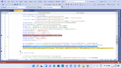

edlaanil
Feature to ploygon with two input polylines to convert to polygon getting error from python script in dot net arc gis pro
kindly help me
