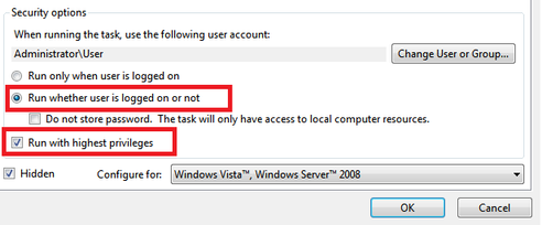

FYI I was referring to the second option below in addition to the first :
Maybe you should consider login a case to Esri support

Correct, I had both those options checked with highest privileges checked in all my tests. Then when testing, I can successfully get the script to fully run when the user is logged on and using the "Run only when user is logged on" option however once toggled to (what I need) "Run whether user is logged on or not" the script fails at the exportToPDF() line of code.
This same code had been running without issue for 1 1/2 years then started failing around late November/early December.
I did initially have an ESRI case open however it has since been closed. ESRI was not able to recreate the behavior. I can recreate it on 3 different servers in my environment.

I will try re-installing to be sure, however I am pretty familiar with the installs so that should be the case (ran as admin).
On the second test server I have available to me I installed and am testing Task Scheduler from my own admin login. So not leveraging the task scheduler (service) user account and still have the issue.
