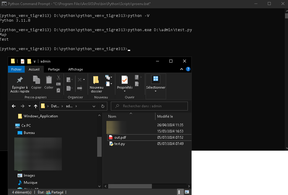

Here is a screenshot with a cloned environment from Pro, version 3.11.8 and PDF is written :

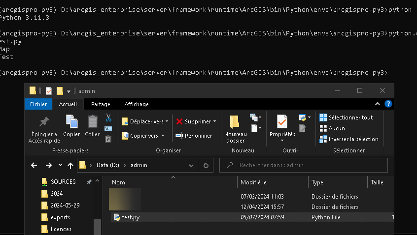

and here with Server's python, same version and nothing happens :
I also tried
try:
    print("try")
    mf.exportToPDF(out_pdf=r"C:\Temp\out.pdf")
except exception as e:
    print(e)
but no exception is returned
