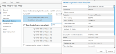

The cause lies with the list of names of coordinate systems for ArcGIS Pro.
Same with ArcMap as well.
