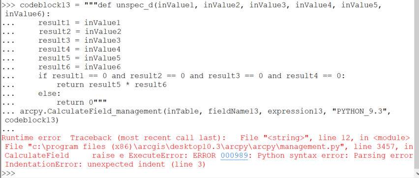

I am still getting an error saying I need an indent even when fix what you mentioned.... not sure why, especially when the code works when I use it in field calculator.

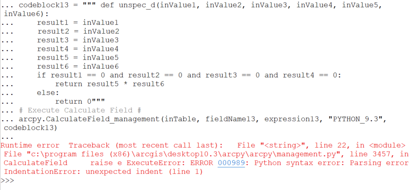

you have a space after the triple quote... remove it

Thanks for the help! unfortunately I am still getting an error message:

Look closely at 'result2 = inValue2' ; to me it looks like it's in one space extra. Compare how the r's line up above that line and below... (Using the syntax highliter rather than a screen shot would help...)
That should just about do it....
