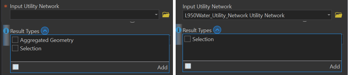

Could someone help me determine the reason I cannot select "Aggregated Geometry" as a result type when I am doing a Utility Network Trace in ArcGIS Pro or in Python? In ArcGIS Pro (version 2.7), the option is there in the geoprocessing tool dialog box when I first open the tool, but as soon as I select my input Utility Network, it disappears.
