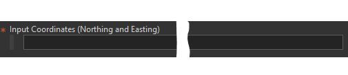

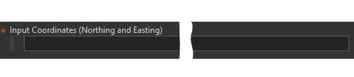

I was wondering if what I would like to customize for a custom script tool is even possible. The user input requires the user input for both the northing and easting coordinates. I was wondering if there is a way to set it up so that the inputs are side by side.
I don't know if this is possible or not but I just wanted to double check.

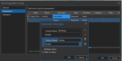

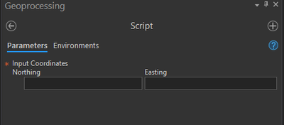

Use a Value Table parameter:
