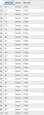

Thanks for responding. I only have a basic understanding (if you can call it that) of python so excuse me for the question, but how would I make this a float? I want to take the Zip Code column and create a new column with decimals. It will look like the second image I've attached, but that was done in excel then joined after. Ideally, I'd like to do it all in ArcGIS if possible.
To answer your question, they have been sorted prior to this and I'll attach a screenshot below.
Noah

The zipcode field isn't the one that is sorted, so a field calculator expression won't work nicely.

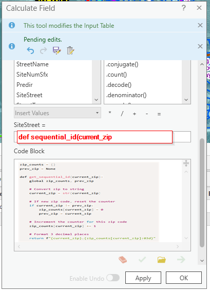

TonyAlmeida
MVP Regular Contributor
Try this, Paste the code above into the "Code Block"
Then def sequential_id(current_zip) int the "field" = def sequential_id(current_zip)
Code
zip_counts = {}
prev_zip = None
def get_sequential_id(current_zip):
    global zip_counts, prev_zip
    # Convert zip to string
    current_zip = str(current_zip)
    # If new zip code, reset the counter
    if current_zip != prev_zip:
        zip_counts[current_zip] = 0
        prev_zip = current_zip
    # Increment the counter for this zip code
    zip_counts[current_zip] += 1
    # Format 3 decimal places
    return f"{current_zip}.{zip_counts[current_zip]:03d}"
NoahSeeton
Hi,
Sorry for the dumb question but I'm really not that well versed in Python (or any coding languages for that matter). What do you mean by "Then def sequential_id(current_zip) int the "field" = def sequential_id(current_zip)".
Noah

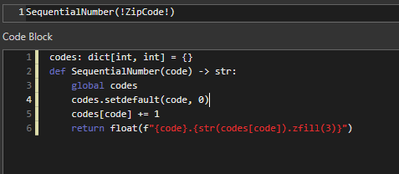

HaydenWelch
I'd just use a .zfill():
codes: dict[int, int] = {}
def SequentialNumber(code) -> str:
    global codes
    codes.setdefault(code, 0)
    codes[code] += 1
    return float(f"{code}.{str(codes[code]).zfill(3)}")
You also can't use a float for this as the __repr__ of a float always removes the trailing zeroes. You need to string format it.
You also REALLY don't want to be adding a value to the zip code. If you happen to add 0.001 1000 times, suddenly 77829 is 77830. Use a mapping with a counter if you need to preserve the zipcode.
To use this in the window you need to pass the zipcode field value to the function:
