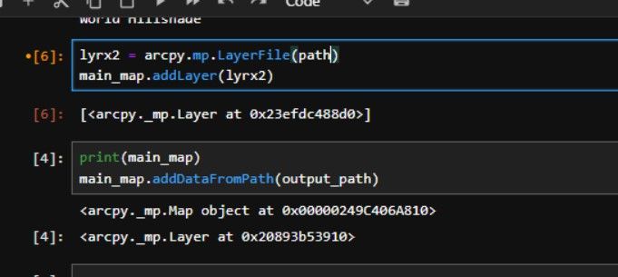

I have tried to add the newly created feature class to my map using a couple different methods: Screenshot 2025-05-16 145837.jpg
These return a layer object but the layer is not added to my map.
