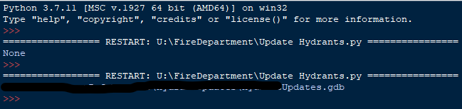

Hi,
I have been trying to figure out why I keep running into this strange issue. I am not sure if I programmed the script incorrectly or if it happens to be an issue with establishing the subfolder first. Here is what I have so far.
import arcpy
import os
def CreateBaseData(location, names):
    subfolder_name = None
    database_name = None
    subfolder = None
    database = None
    for name in names:
        if '.gdb' in name:
            database_name = name
        else:
            subfolder_name = name
    for root, directory, filenames in os.walk(location):
        if directory:
            if directory[0] in names:
                if database_name == directory[0]:
                    database = os.path.join(root, directory[0])
                elif subfolder_name == directory[0]:
                    subfolder = os.path.join(root, directory[0])
                else:
                    pass
    if subfolder is None:
        subfolder = os.mkdir(os.path.join(location, subfolder_name))
    else:
        if database is None:
            database = arcpy.CreateFileGDB_management(subfolder, database_name)
    return database
# Create folder and file geodatabase
WorkingFolder = r'*'
subfolderName = 'Updates'
databaseName = 'Updates.gdb'
names = [subfolderName, databaseName]
database = CreateBaseData(WorkingFolder, names)
print (database)
Here is what I get as a print statement for the first, then second execution.First execution.png
Any help on this would be greatly appreciated.

RhettZufelt
MVP Notable Contributor
I can't get past line 16 as it doesn't seem like the * passed as a path in line 35.
The filename, directory name, or volume label syntax is incorrect: '*\\Updates'
Have you tried hard coding the WorkingFolder and see if you get past the error?
R_
RhettZufelt
Once I hardcode the working directory, it appears as if it is not getting past this part:
        if directory:
                else:
                    pass
Since the "Updates" folder doesn't exist yet, nothing past the if directory[0] in names: resolves to true.
So when it hits this part:
    else:
the subfolder doesn't exist, so it creates it.  BUT, it doesn't execute the else: as the first part was true.
Then next time you run it, subfolder now exists, so is not None, so it executes the else: statement and creates the FGDB.
Think you need to deal with checking/creating the working folder before you walk through it. Or, just have it check if subfolder exists and database doesn't, create it.
