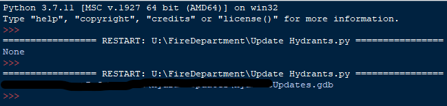

Here is what I get as a print statement for the first, then second execution.First execution.png

Once I hardcode the working directory, it appears as if it is not getting past this part:
    for root, directory, filenames in os.walk(location):
        if directory:
            if directory[0] in names:
                if database_name == directory[0]:
                    database = os.path.join(root, directory[0])
                elif subfolder_name == directory[0]:
                    subfolder = os.path.join(root, directory[0])
                else:
                    pass
Since the "Updates" folder doesn't exist yet, nothing past the if directory[0] in names: resolves to true.
So when it hits this part:
    if subfolder is None:
        subfolder = os.mkdir(os.path.join(location, subfolder_name))
    else:
        if database is None:
            database = arcpy.CreateFileGDB_management(subfolder, database_name)
the subfolder doesn't exist, so it creates it.  BUT, it doesn't execute the else: as the first part was true.
Then next time you run it, subfolder now exists, so is not None, so it executes the else: statement and creates the FGDB.
Think you need to deal with checking/creating the working folder before you walk through it. Or, just have it check if subfolder exists and database doesn't, create it.
