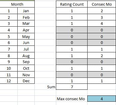

I'm trying to replicate in Python something done in excel:
I have a set of 12 rasters with values 0 and 1, each raster representing a month of the year. I need to create an output raster that will count the maximum number of consecutive months occurring. In the excel example above the result is 4 as it starts in December and accumulates through until March. So it is looping through all months.
I have the column called "Rating Count" above sorted. The problem I encounter is with Jan in the "Consec Mo" column as this value is not fixed because it is fed from the December value in the same column.

Sorry bit confused here.
I can see that Dec14, Jan15, Feb15, Mar15 are consecutive.
But how do you know that Dec is the previous year and not 8 month later?
anTonialcaraz
Thanks Neil. Sorry, I probably didn't explain myself properly.
I'm not dealing with years here; just months of any year. I need to calculate cumulative number of months that hold data (in this case value 1). The calculation should loop through the 12 months with no fixed starting point.
Hope it is a bit more clear now. Thanks again!
