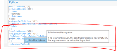

Why would cim_lyr.featureTable.fieldDescriptions return an empty list when the feature layer clearly contains fields? @JeffBarrette @JeffMoulds

MarvisKisakye1
According to property tip in the image above, there is an expectation for an argument for the fieldDescriptions property otherwise it creates an empty list.
