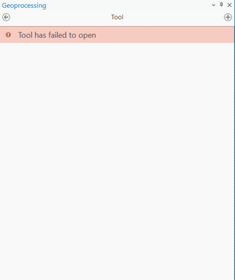

The import resolves, but calling the func always breaks tool. These are the things I tried (with only one func at a time named test_method):

When called from execute, #3 builds but gives this when executed, even though #3 does not even have a "self" arg. These are all static methods. #1and #2 just do nothing and fail silently - the worst kind of failure.
TestClass.test_method() missing 1 required positional argument: 'self'
All of them break getParameterInfo if put there.
