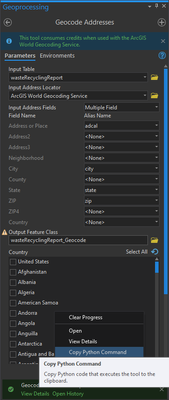

I just stumbled onto something that works. Run the Geocode Addresses geoprocessing tool with your parameters. Right click the "completed" green ribbon > Copy Python Command. Then copy this into your script.
This is how it looks after setting the results to variables. Funny, the URL never changed. But the parameters don't look the same as the help page example.
