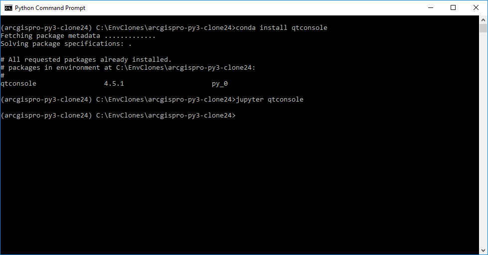

Dan - can you elaborate a little bit?  I just installed/upgraded to 2.4 and laughed when I saw the same old python window.  None the less, I added the jupyter package to my clone, and then following
Jupyter QtConsole Getting Started
I ran conda install qtconsole from a python command window in my env-clone directory.  It returned
So it was already there.  How do I get it to execute, and how do I use it as my python command window in Pro?  When I run 'jupyter qtconsole' from a cmd window it doesn't recognize jupyter; when I run that in a python command window (above) nothing happens....
