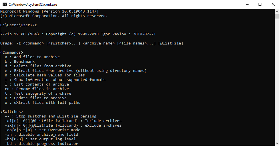

and this message proof that I have 7zip installed in my environment

You ran 7z from the windows command prompt. Have you tried seeing if the PATH variable is set correctly within the arcgispro-py3 environment?
This looks like part of a tutorial of some kind so my guess is you missed a step in the tutorial to set up this path within the arcgis-py3 environment.
