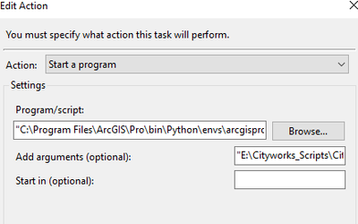

7.  Set the Action to Start a program.  The Program/Script needs to be set to the path of your python executable (python.exe). In the below example, the script will be executed using Python 3.x, so I will specify the path to the python.exe for my ArcGIS Pro install.  This is generally located at:  "C:\Program Files\ArcGIS\Pro\bin\Python\envs\arcgispro-py3\python.exe"
The Add argument will be the path to my script:  "C:\Projects\Scripts\NWM_UpdateFlow.py"

One thing that was stopping ours from working was not having the quotes (like this example "xyzx") around our "Add arguments (optional):  input box.  Ours looks like this:
