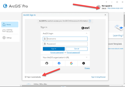

In our environment, I have a dedicated server where the scripts are stored, and ArcGIS Pro (3.3?) is installed there to get the Python 3.x installed. Pro is licensed through our ArcGIS Online account, and I have a dedicated login just for use with all of the Python scripts. I create a new instance of Python (through Pro) to add libraries (such as Pandas) and save this in a local directory with access permissions to everyone.
The Python scripts are run by using a batch file (i.e. DailyAPCDownload.bat) to access the correct Python version and the local py file, and look like:
"d:\python3\envs\propy05_17_2024\python.exe" "D:\Projects\Hastus_APC\DailyAPCDownload.py"

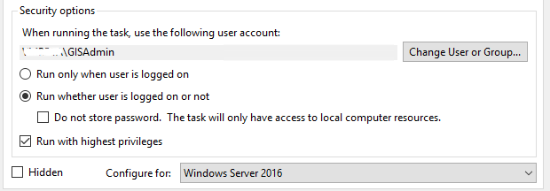

In the Task Scheduler, the run time is set to daily and the action is set to this batch file which looks like:
Every task is set to run using a system account, and to run when the user is not logged in using the highest privileges:
The scripts have started to use ArcGIS Python, but still rely a lot on Arcpy, and I call SQL Server stored procedures a lot, as in:

I know it's a lot, but just for the example of how I used ArcPy, ArcGIS.GIS, and Pyodbc for connecting to SQL Server stored procedures (and sometimes being lazy and doing the SQL inline). I'm sure some of this could be cleaned up, but it's working, when Task Scheduler runs the program.
Under ArcMap, and Python 2.7 I rarely experienced an issue, but now that it's relying on Pro, every once in awhile I need to open Pro, check the Python environment ( a couple of times the created one went bad for some reason) and then close the application. Then everything works fine.
On July 13th something happened to the server and it rebooted. I was gone for a week, but when I returned none of the scripts were being run by Task Scheduler, and none had run since 7/13. I logged in as myself, and had no issue with running them through IDLE (for Pro), or through the BAT file. I logged into Pro and checked the Python environment and everything seemed fine, but nothing was running in Task Scheduler. Only after logging into the server using the service account, and then opening Pro and checking the environment, did things start working in Task Scheduler.
So my question (thanks for reading this far, I know this is supposed to be higher up, but I thought the buildup would help) is:
Does this setup seem like a reasonable way to run tasks automatically?
We have multiple scripts running every day and this new way of using ArcGIS Pro seems a little too sensitive. I wish there was someway to set the access and forget it, but maybe the accessing of the Pro license through ArcGIS Online should be localized?

I'm not sure about how to 'have the sign in automatically selected', and looking at the options in Pro I cannot locate that option.  I did notice the option (under licensing) to 'Authorize ArcGIS Pro to work offline', which is disabled since I haven't converted any of my licenses, but maybe that should be the preferred way to ensure timeout doesn't occur?
I do like your approach however, so I will try that first. Thanks.
RhettZufelt
MVP Notable Contributor
It is on the sign in screen itself:
