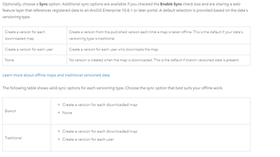

I did some research into this and found the following link which shares more details:
Configure a web feature layer—ArcGIS Pro | Documentation under the step 13:
I can do some more digging into this, if this doesn't clarify what you are looking for. Please let me know if this answers the details.
Hope it helps!
