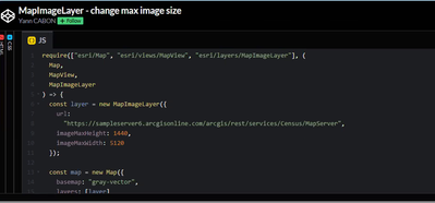

I have a concern related the ultra wide monitor,  When trying to configure the max height and width, it gives me the result displaced than it should be. Is it a known limitation or something? as the issue appears only on the Ultra wide monitor.
Thank you.
Scott_Tansley
MVP Regular Contributor
Have you changed the setting in the server?  That looks like the app.  The app can ask for the wide but if it’s wider than the server will present then it’s useless???
