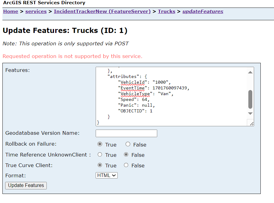

"I am attempting to utilize the REST API to update the Feature Service on ArcGIS Manager. However, I encounter an error stating, 'Requested operation is not supported by this service' during the update process.

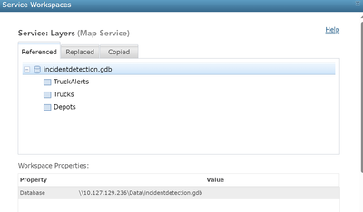

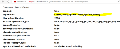

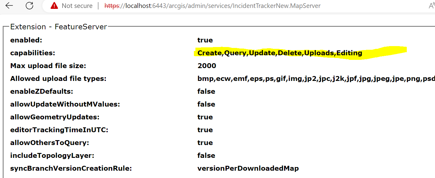

I have deployed the Map Service using the 'Publish Map Service' feature in ArcGIS Pro to a Standalone Server with the 'Copy Data' option enabled. Additionally, I have activated the Feature Server option with Update and Create permissions in the Server Manager portal. Despite these settings, I continue to face errors while attempting updates. I have attached a screenshot for your reference. Could someone kindly offer guidance on how to proceed?"

@HarishKV , I have tried using geojson still it fails and give same error "Requested Operation is not supported by the Service". Below is the geojson I am using for testing

Thanks for sharing the screenshot. That is very helpful. As you see, the service is pointing datasets inside from a FileGDB. Feature Service (aka the Feature Access extension of map service) can't be enabled when data resides in a FileGDB. It must be in an enterprise database for allowing multi user editing.
I see you published with 'copy data' option - that begs the question why do you need support editing capability when this filegdb lives in a managed location and will get deleted when you delete this service?

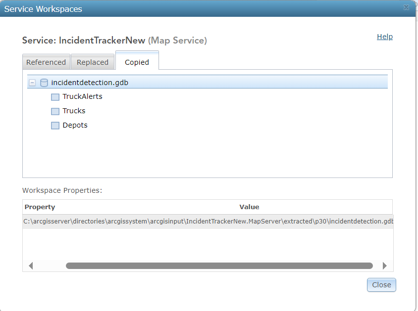

Cause of the Problem:
As far as, I could understand from the description, you created a Map Service first with Data copy and then enabled Feature access. This workflow will not allow the editing/update features on the service as when we initially publish a "Map Service (with data copy to Server)" it creates a "File Geodatabase" in "arcgisinput" (as you have already noticed) folder by design. After that if you enable "Feature access", the data still resides in "File Geodatabase" causing the requirement of capability to not fulfilled. Hence, the resulting error.
