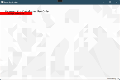

I load package1 (mymap.vtpk) into the map on startup, then on button click I copy package2 file into package1 file. No error. The only thing I notice is that the map stops rendering details:
I realize this might not be the best way to test it due to the packages containing different maps.
What would be the recommended way to update a local package (that is loaded into the application) while the application is running? Could it be as simple as this?
