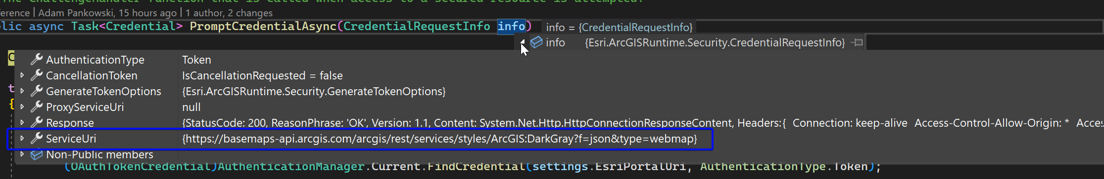

After investigating it deeper I think in the Basemap API calls there is no Token being passed.

Basemap prompt request without Token from SDK.
Esri.ArcGISRuntime v200.0
Esri.ArcGISRuntime.WPF v200.0
Esri.ArcGISRuntime.Toolkit.WPF v200.0

Maybe it has something to do with the Esri Portal version?
Is this an on-premise portal? For basemaps to work, you'll need to sign into the arcgis.com / ArcGIS Online portal.
Coolodporny
That's maybe it. Indeed, I am using an on-premise portal. To make the base maps work from version 200+ will the user need to sign in to the on-premise portal and then to the official ArcGIS Online Portal?
SomeGISGuy
Yes to use the arcgis location services you need to either:
1. Sign into ArcGIS.com before accessing the services
or
2. Set the ArcGISRuntimeEnvironment.APIKey property to an API Key you generate on the developer's website.
This isn't a new 200 thing. This was also a requirement in 100.x, unless you were still using the deprecated map services (which have been removed from 200).
