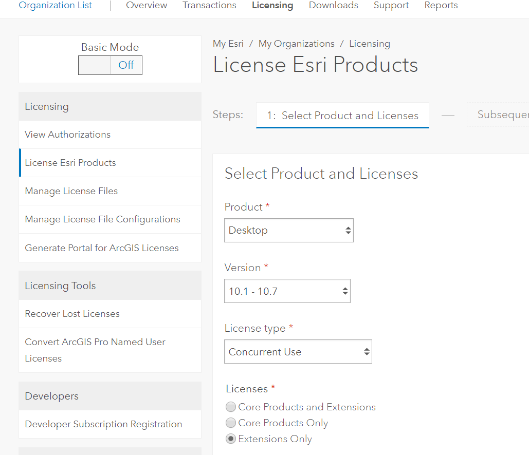

One way to authorize (I think this is the most simple):
In order to create a provisioning file got to licensing the License Esri product select versions and tick Extension only. then go ahead, select the extension in the list,  fill in the info and generate the file, download it and then double click on it. follow the instruction in the window that opens and click next till the end.
