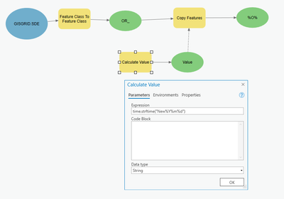

I am having problem to add date to my file

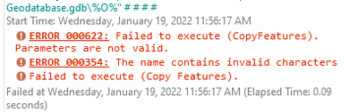

I am getting this error in ArcPro

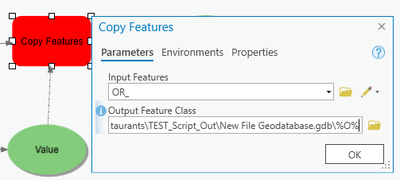

I am having problem to set copy features output. I tried with code here too
