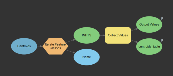

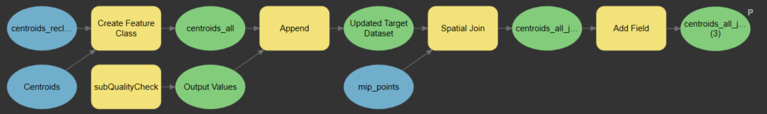

Right now my model is supposed to process around 260 feature classes (each of them contains single point) into one feature class. All feature classes are located inside geodatabase in one feature dataset. For that purpose I am using submodel which iterates through the dataset and with use of Collect Values tool it allows me to append all the feature classes into one class.
Unfortunatelly the processing time for that test dataset is around 4-5 hours, which is too long. Is there any option to optimize the model and make it faster? Below you can see screenshots of my submodel and main model.
Main model:
Submodel:

Ok, so I was able to optimize my model by reducing operations.
Main reason for increasing processing time of each feature class is probably due to use of feature classes with single points in each of them.
Previously I had about 3 models, where 1st was getting centroids from reclassified rasters by iterating through those rasters and saving each calculated centroid feature class into geodatabase, 2nd was iterating through created centroids feature classess to create a list of those with Collect Values tool and final one was appending all those feature classess into one feature class.
To make it quicker I skipped 2nd model and used Collect Values tool in 1st model. Also I used memory-based workspaces for all intermediate data.
