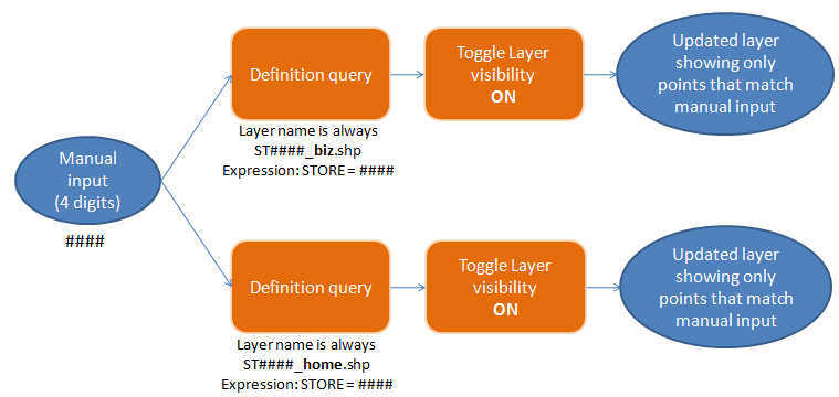

I'm trying to build a very simple model in where I can type 4 digits and then show the layer with only the points that match the query.
The workflow would be something like this: (drawn in powerpoint)
then on a Layout, I need to change the test to reflect the store number in the title.
Any ideas on how to build it?
The rationale behind this is that I need to export Layout 150 times with twice as many layers...
Running an itereator is not feasible as I need to adjust the vivibility (extent and map scale) and export the layout after this is run...

the P would mark the spot as a model parameter

so I managed to select the exact polygon I'm interested in using Select Layer By Attribute
How can I make it the only displayed polygon(s) according to my query? as if I were using a query...
Then the interesting part will be toggling another layer visibility based on its name...

as Definition Query  is not a tool, I'm unable to add it to the model... any other ways to draw only selected features?

Short of making a separate layer (which could reside in-memory) I can't think of anything if definition query isn't available ...  in modelbuilder ... but I haven't had a look through the whole link yet.

Ok... I'll give it a try. How can I create a layer to reside in memory? (I understand this would create a temporary layer without creating a separate file?)
I don't want to die with another 300 layers...

In memory for PRO is in the link... effectively just a workspace that is temporary unless the results are saved.
