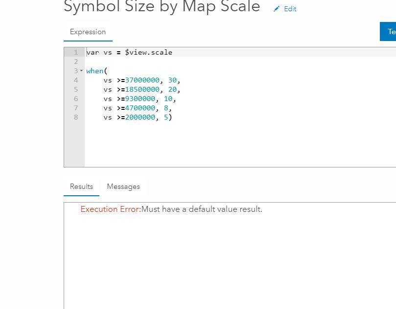

I am trying to create a custom expression on a feature so that it will re-size the symbology as I zoom in and out. Like this example ESRI Blog - https://www.esri.com/arcgis-blog/products/js-api-arcgis/mapping/how-and-why-to-adjust-size-by-scale-...
However, everything I try, I keep getting errors.

This is where I left off, basing off of the blogs:

jcarlson
MVP Alum
You can refer to the When page, but basically you need a default value at the very end for when none of the conditions are met. Just add ", 5" before the final parenthesis.

KamillePreto
Hi Josh,
Thank you again. My script already has a ", 5" before the final parenthesis, so I added another just to see if it would work, but I am now getting a "Parse Error: Line 8: Unexpected identifier".
var vs = $view.scale
when(
vs >=37000000, 30,
vs >=18500000, 20,
vs >=9300000, 10,
vs >=4700000, 8
vs >=2000000, 5, 5)

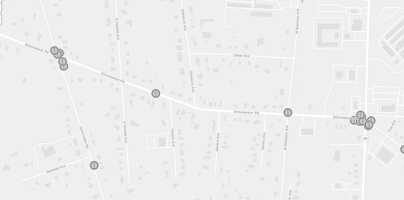

But I don't believe it worked correctly. The symbols get smaller when I zoom in, and I wanted them to get larger. I also don't know what the legend is counting (>40, 30, 20, 10, etc). I still think I'm doing something wrong. Am I typing in the view scale incorrectly? I'm just super confused.
jcarlson
MVP Alum
So, those numbers you're defining with your expression are just arbitrary values, they're not directly setting the symbol size number. What you'll need to do is to open the symbology settings to adjust the min/max values, as well as the min/max symbol sizes to match the min/max values from your expression.

KamillePreto
I'm sorry, maybe my last question wasn't clear. I don't have the "View Scale Based" symbology options where you can customize a min/max. I only have the normal symbology options - choosing a symbol, transparency and visible range.
jcarlson
MVP Alum
On your own screenshot, you have circled the options button.
"View Scale Based" is simply what I titled my expression.
