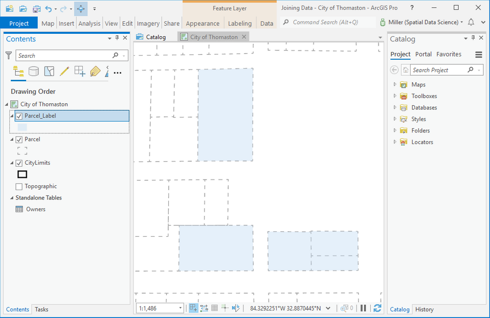

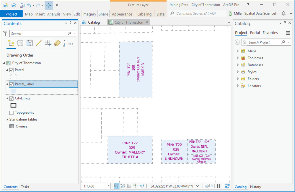

Funny thing is I found my label showed when it was at lower layer, but hid when it was at top layer. See below images.
