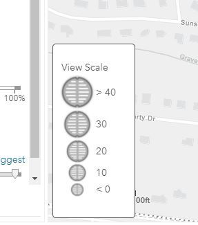

KamillePreto
Hi Josh,
Yes, I am very familiar with the Options button. When I selected it the first time, that sliding bar with the min/max was not there. Now after re-entering the expression again, it is. But I still do not think it is correct. When I zoom in the points get smaller. When I zoom out, they get larger. I wanted that flipped. So I went back into the expression and switched the numbers from top to bottom and it is still doing the same thing. So I changed the slider (min/max) and that does work. But I just don't understand what the legend is referring to. What are the numbers? - If they are the second numbers in my expression (25, 20, 15, 8), those were just random symbol sizes I assigned to the zoom levels. Not attributes.
