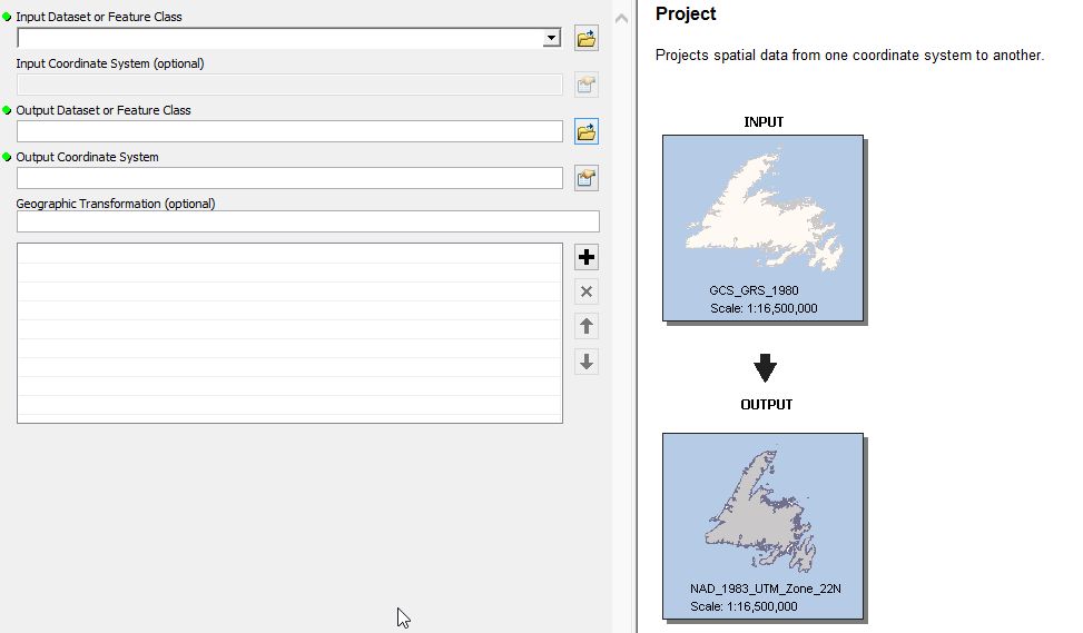

Greetings....I have received a mdx file from an outside source. It is in NAD 1983 UTM 15N. I would like to work in it using a state plane coordinate system. Can someone tell me how to change that? Thanks
11 Replies
ArnoldKuilman
Deactivated User
Change the projection with the "Project" tool:
KenricMcCay
Follow what Arnold Kuilman‌ said.  If it is in NAD 1983 UTM 15N, be sure to choose that as well when you get to the "Project" screen.  Then choose the one you would like for the "Output Coordinate System".
