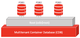

Yes, it is recommended to use Oracle Pluggable Databases to store the Oracle ArcSDE Geodatabase.
To enhance the process of consolidation, it is highly recommended to adopt the advanced capabilities offered by the Oracle 19c multi-tenant architecture. In this framework, the container database, commonly referred to as CDB, will serve as the central host for multiple pluggable databases, known as PDBs. Each of these pluggable databases operates independently, functioning as a standalone geodatabase that comes equipped with the necessary ArcSDE repository installed for optimal performance and management of spatial data. Furthermore, it is advisable to discontinue the use of Esri user-schema geodatabases, as shifting to this new architecture promises more efficient data management and scalability options.

  • To avoid these issues, it is best practice to transition to an Oracle Container Database and utilize Pluggable Databases (PDBs).
  • Each PDB should serve as a separate geodatabase tailored to specific data models and data separation needs.
