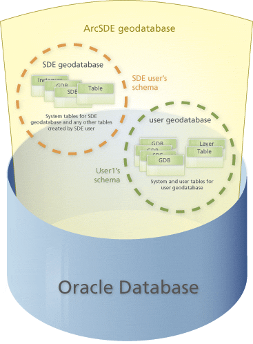

1. INTRODUCTION
ArcSDE User-Schema Geodatabases in Oracle are deprecated.

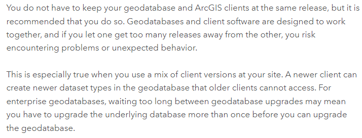

3. GEODATABASE COMPATIBILITY
ArcGIS Pro and Geodatabase compatibility
