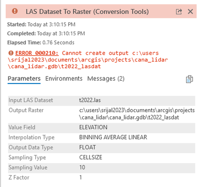

AndileMposula
The reason you get this error is because your input is a las file data type instead of las dataset. Use your las file to create las dataset and all should work.
AndileMposula
And don't forget to suffix with ".tif" when naming output.

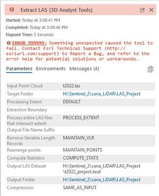

sandipriz
Hi David,
Thanks for this post as I was having trouble converting raster from .las file.
As suggested, I tried to export the .las file with projection but it throws an error again.
Any suggestion would be helpful.
