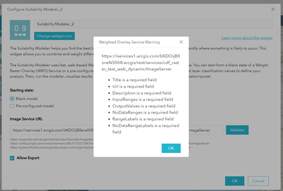

Hi Community,
Has anyone else attempted to publish an image service to ArcGIS Online and received the following errors when opening it in the Suitability Modeler tool.
How can I correct these metadata errors given that the service is not editable with ArcGIS Online. Where are these configured during the publishing process?
  • Title is a required field
  • Url is a required field
  • Description is a required field
  • InputRanges is a required field
  • OutputValues is a required field
  • NoDataRanges is a required field
  • RangeLabels is a required field
  • NoDataRangeLabels is a required field
I have tried publishing different versions of Dynamic Imagery layers but all receive this same issue in the tool.
gmorales3
Were you ever able to resolve this issue? I am having the same exact problem. Any insight is appreciated!
