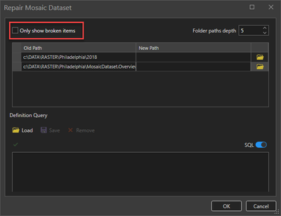

Hi @WarrenMedernach if you right-click on the Mosaic Dataset > Modify > Repair Broken Data Source Path, are there any reported broken paths?
WarrenMedernach
Thanks Jake.  I figured it shouldn't have been anything related to actual mosaic itself as it's working fine on the 'live' system, it just wasn't working on the replicated system accessing the exact same data.  It turned out to be a permission issue for the arcgis service account on some of the server system folders after the deployment.  It all seems to be working fine now.
